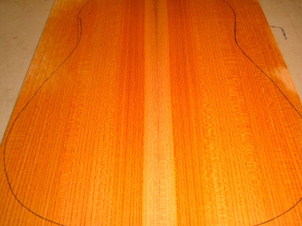

Let me guess: you sanded the top with some relatively fine sandpaper and a random orbit sander, correct?
Guys, you can get this type of figure in just about any softwood, even red spruce or cedar(cedar can show this figure in a very pronounced fashion!) using that technique... The more meds, the more pronounced, but it'll often show well even if no meds were present.Mario38797.4356944444

Oh, and no, a "speedbloc"-type sander isn't a random orbit sander. It needs to be a high speed circular motion sander.
try it!

Actually a random orbital sander does not help the figure become clearer....a very fine sandpaper by hand seems to work though. If this technique works in all softwoods, great, I'll try it again because I like the look. I'm surprised that very few have experienced this figure though if it was so easy to accomplish, interesting.

A random orbit(not the litle square sanders, a 5 or 6" disc one) with 400-500 grit really brings it out.
Many of us have seen it, but most of us avoid it. I'll sand that fine to check the surface, then come back by hand for a coarser grit and a block and follow the grain, to eliminate this figuring most of the time.
Why would I do that?
a) it is distracting after a while; It's cool at first, then starts to look "busy" to my eyes. Others will love it, though...
b(and this is the biggie)) if you 'cut through' in the finish stages, you now need to strip the entire top, and re-do it, because you'll never get the figure to match in a touch-up.

[QUOTE=Mario] I'll sand that fine to check the surface,
Check the surface for what, Mario? Is this prior to finishing?
PostPosted: Wed Mar 22, 2006 7:10 am
Posts: 908
Check for dips, bumps, dents, that kind of stuff. Yes, before finishing....

I experience it all the time, but the funny thing is I try to get rid of it. I don't much care for that look. I prefer the nice straight rows with the cross silking...
